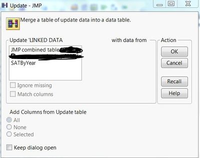

The problem is that I cannot see the Excel file listed in the Update Table dialogue box, even when only the JMP dt and the Excel (updated) file are open. JMP still shows 3 file names with no relevance + they are not opened on the computer right now (please see the enclosed screenshot). Thanks

Phil_Kay
Staff
Re: Is there a refresh option to update data table in JMP 13.2.1
Hi,
It is not clear to me if you have the Excel file open as a JMP table. It will need to be open as a JMP table for you to select it in the Update Table dialogue.
Regards,
Phil
abdul_saqib
Level III
Thanks Phil. It works now. Previously, I missed the point that the Excel sheet needs to be opened as a JMP dt.
