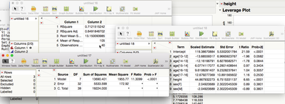

Here's a script that creates three data tables from the Summary of Fit, Analysis of Variance, and Scaled Estimates reports from Fit Model using Big Class.
dt=open("$SAMPLE_DATA\Big Class.jmp");
fm=dt<<Fit Model(
	Y( :weight ),
	Effects( :age, :height, :sex ),
	Personality( "Standard Least Squares" ),
	Set Alpha Level( 0.1 ),
	Emphasis( "Effect Leverage" ),
	Run(
		:weight << {Summary of Fit( 1 ), Analysis of Variance( 1 ),
		Parameter Estimates( 1 ), Scaled Estimates( 1 ),
		Plot Actual by Predicted( 1 ), Plot Regression( 0 ),
		Plot Residual by Predicted( 1 ), Plot Studentized Residuals( 0 ),
		Plot Effect Leverage( 1 ), Box Cox Y Transformation( 0 )}
rep_fm=report(fm);
rep_fm[Outline Box("Summary of Fit")][Table Box(1)]<<make into data table;
rep_fm[Outline Box("Analysis of Variance")][Table Box(1)]<<make into data table;
rep_fm[Outline Box("Scaled Estimates")][Table Box(1)]<<make into data table;
As you can see, it creates three data tables with different column and row configurations.
How do you want these combined into one data table. Concatenating them would result in a strange looking table like this:
Without a matching column you can't join them either. So, I'm confused about combining them.
