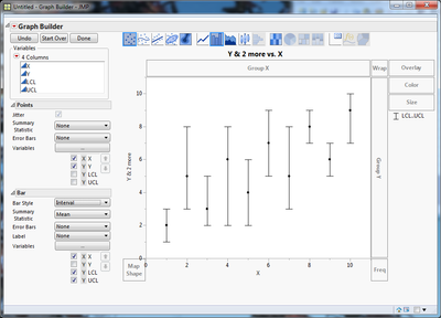

pmroz
Re: Is it possible to create an overlay plot representing confidence intervals?
Hello Myriam,
You might find it easier using Graph Builder.  Suppose you have a table with the following columns: X, Y, LCL and UCL.  Bring up GB on this table.  Drag X to the X axis.  Highlight Y, LCL, UCL and drag to the Y axis.  Click the icon for points, and then shift click the icon for vertical bars.  Right-click inside the graph and select Bar > Bar Style > Interval.  Then, under Points (left side) click on Variables and deselect LCL and UCL.  Under Bar click on Variables and deselect Y.  Should look like this:
If you run the code shown below inside a script window you'll get the final result.  Uses JMP 11 btw.
Thank you very much for this step by step explanation, this answers my
question.
