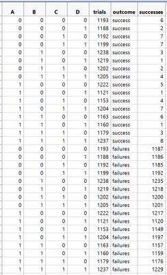

Here in the attachment you can see my jmp dataset file with the experiment.

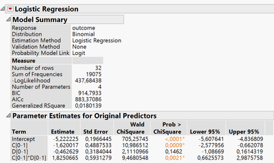

As a result of removing non-significant elements I came to a conclusion that only C and В are significant with negative effect.
Is my conclusion correct?
Rsquare value is very low however chisquare value for elements is significant.

First of all, binary responses often lead to very low R square even when there are significant relationships. It just means that there is a large uncertainty in the predicted outcome for given conditions. It might be due to lack of fit, but again, it is very common with such a response.

What I noticed is that the probability of a success is EXTREMELY low. The highest probability of a success for any experimental condition is 0.006. This causes a problem because I don't even need to consider your factors. If I always predict a failure, I will be correct at LEAST 99.4% of the time. That's a very good model. It is not very informative, but it is good. This will cause issues for any modeling approach.
I think you should correct the data issues and rethink the analysis approach and what information you are looking for from the analysis. Best of luck.

Sorry I mistakenly named successes column, it should have a name of count. If I understood your question correctly.

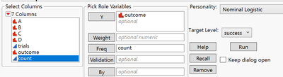

So is it better to use Nominal Logistic regression to define significant variables and binomial GLM for interpreting their effect size?

I think that either logistic regression or binomial GLM can be used for deciding about significant effects and interpreting the nature of these effects.

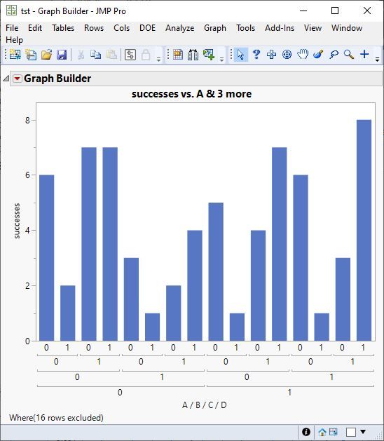

I know that if there is a significant interaction effect then we should include it in a model even though one of the main effects may not be significant. As it is the case. But how can we interpret the fact that when С at 0 level and D at 1 - we have a decrease in success rate by 50% while В is not significant.
However, when С and D both at level 1 they increase success level by 20%.

What does you knowledge of the process in question tell you over and above p values and other statistical measures? Process knowledge takes precedence over statistics...if the interactions make sense from a physical understanding of the system...then unless some nuisance or noise variable jumped up and bit the experiment...go with your knowledge.

Your case, change C from 0 to 1 while holding D at 1 is not an example of an interaction. It is just the conditional effect of changing C.
