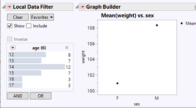

To see a simple example, replace the Graph Builder section in the script above with the following:
Graph Builder(
	Size( 271, 266 ),
	Show Control Panel( 0 ),
	Variables( X( :sex ), Y( :weight ) ),
	Elements( Points( X, Y, Legend( 2 ), Summary Statistic( "Mean" ) ) ),
	Local Data Filter(
		Show Modes( 1 ),
		Mode( Include( 0 ) ),
		Add Filter(
			columns( :age ),
			Display( :age, N Items( 6 ) )
Since the categories F and M include data from all ages, the mean points will show no matter what ages you choose to show with the local data filter. You may also notice that the mean points remain the same no matter what ages you choose to show. That is because the mean calculation is based on Included rows in each category and we are not excluding any rows with this local data filter.
If you were to remove or exclude the only 16 year old Male, the Mean point for the M category would change and be hidden only when you select (to show) age = 16 in the local data filter.

Thank you John.  You are correct that I was only using a single Data Filter with multiple filters and the example you have just provided is pretty much exactly what I am doing (and how things are/or are not working).  You are correct that the mean data points never change even though I filter for different ages since the "Include" has been deselected.  Am wanting to show how the lines move with the different filters but that requires the "Include" to be selected so might have to figure something else out.  Thanks again for the help.
