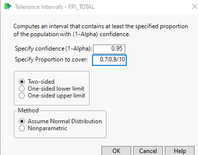

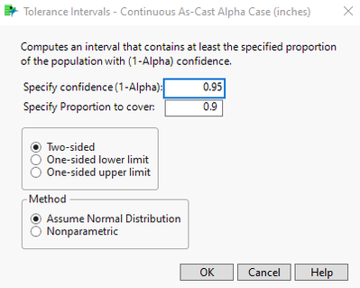

Hello everyone,
I am looking at putting in a wish list item but wanted to get some added input from the user community.  I was thinking it would be great to add to the Prediction and Tolerance interval Platforms the ability to put in a range and an increment by value into the input box so you wouldn't have to enter each scenario you are interested in one by one.
For example, if I wanted to see what the tolerance interval looked like for 70, 80, and 90 Portion to cover I could input something like 70:90/10
I believe there is syntax in JSL already to do this so might just copy what that looks like as the input.
So the question is: is there already a way to do this outside JSL that I am just missing.
I also don't think that this should be limited functionality to the Tolerance and Prediction analysis but that was the genesis of my wish list idea.
Thanks for any input!
Steve

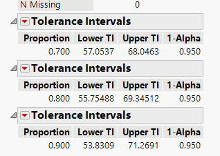

Seems like this is simple to do in JSL (assuming this is what you want)
Names Default To Here(1);
obj = dt << Distribution(Column(:Height));
obj << Tolerance Interval(Alpha(0.95), Proportion(0.7));
obj << Tolerance Interval(Alpha(0.95), Proportion(0.8));
obj << Tolerance Interval(Alpha(0.95), Proportion(0.9));
This is something that could be most likely easily "injected" to distribution platform (or create your own window for it which isn't annoyingly modal window) which would then allow you to easily add different proportions.
