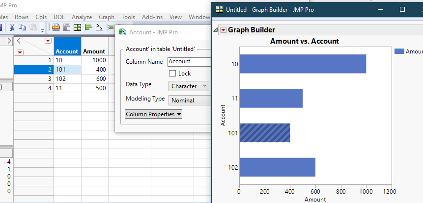

Hi,
I've recently found something curious in JMP Pro 14.2 : The default value of the value ordering property of a character column is not necessarily consistent with the sort order of the same column. An example : The French chart of accounts uses an articulated code as the ID of defined accounts. In such a system, 101 is a subdivision of 10, and so on. Thus, the ID must be stored as a character column, in order to have a sort order like 10, 101, 102, 11, 111, 12... Then all sorting operations or Col rank functions work fine but: the default value ordering in several plot is incorrect. Even when adding a Value Ordering property on the column, the defaut order defined by JMP is 10, 11, 12, 101... As an ordinary chart of accounts might have several hundred IDs, manual reordering is not an option.

Here is the example :
But I think I've got the answer a few minutes ago, watching John Sall's demonstration in Copenhagen JMP Europe Discovery Summit : This behaviour is new in JMP 14, named by John as "ghost ordering" or intelligent ordering of categorical data.
The solution to my problem is then derived from what John Sall showed with value labels in the same video: Simply sort the table by account (no ghost ordering here), copy the entire colum and paste it in the Value ordering property box. One just have to first remove all values added by JMP before pasting and everything is OK.
Thanks a lot for your answer and I think the problem is solved now.
