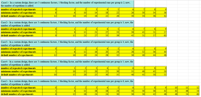

I’m still not fully clear about how the minimum and default number of runs are calculated in Custom Design after adding replicate runs.
I’ve summarized the logic in a table, but I still haven’t figured out exactly how the minimum number of runs changes as the number of replicates increases.
Could you please explain each case in my table?
Thank you very much!

Hi @CompositeCamel5,
I think I have been patient enough on your two topics, this one and In an augmented design, if the original experiment includes block factors, when conducting an augmen... , so I won't deep-dive into each of your 5 use cases with all the different settings you have.
For all the situations you have listed, you have my responses to help you : without replication, the minimum number of runs corresponds to the number of terms to be estimated ; with replication and/or when adding centre points, you need to have the minimum number of runs depending on your model + the number of replicates or centre points you have specified as a minimum.
