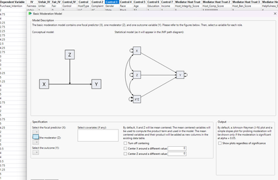

I have the same problem. Please see the screenshot below. When trying to select the X, Y, and Z variables, the dropdown doesn't show any (I am trying to use the Moderation and Mediation add-in).

Re: Impossible to select variables in the analysis windows
I believe this behavior is due to a known problem with certain graphics cards described in JMP Note 67990. First, try turning off the "Enable hardware accelerated graphics" preference in JMP. This helps almost all of the time, and alternatively, you can update the graphics card as noted in the JMP note.
