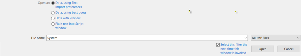

     The easiest way is to make JMP give you the script for importing the file - so you can customize the selections and reuse the script.
    File ==> Open ==> Select the file you want
    It will provide an interface like so. You might want to chose "Data with Preview" so you are aware of what you are importing and can customize. Once you are done, click on the Green triangle , it will provide an option to "edit" where you can see the script JMP generated
Best
Uday

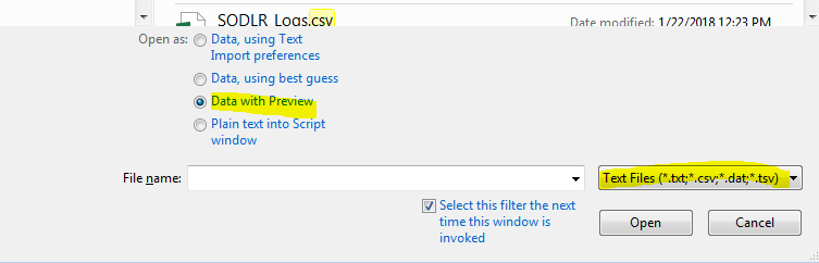

Just a point of clarification on @uday_guntupalli response:
It will provide an interface like so. You might want to chose "Data with Preview" so you are aware of what you are importing and can customize. Once you have completed the importing, go to the imported data table.  Look in the Table Panel on the left of the data table display. Right click on the Green triangle in front of the "Source" item, it will provide an option to "edit" where you can see the script JMP generated.  You will then be able to cut and paste that script into the beginnings for the development of your weekly script.

Hi @NilD,
JMP will generate the script for you if you can import it manually the first time.  The resulting table will have a script "Source" that shows exactly how to import the data using JSL.
If JMP doesn't import the .csv file correctly, then do the following.  Do File > Open (or Ctrl + O) as usual (changing the file types in the Open Data File window to "Text Files" if needed) , navigate to the .csv file and select it.  Before opening the .csv, you should see some radio buttons giving you different options for opening the file.  One is "Data with Preview."  Selecting that will give you the opportunity to alter the import settings before bringing the data into JMP.
-- Cameron Willden
