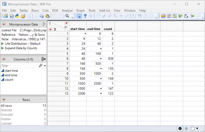

These two references should be relevant:
1) JMP documentation: https://www.jmp.com/support/help/en/18.0/#page/jmp/launch-the-life-distribution-platform.shtml
2) This JMP data table among samples tables that come with JMP:
