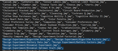

What do you need explained about recursive(1) option?
Names Default To Here(1);
Files In Directory("$SAMPLE_DATA", recursive(1));
Without that option you will just get the first level of files in the folder and when using recursive you will also get the subfolders and files inside those.
Highlighted ones are there only because recursive(1) was set.

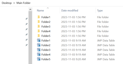

Hi, I only have two levels of folders the main folder then the multiple folders with the CSV inside. Here is an example output of the script without using recursive. What I would want to do is when the script run, only the Main folder will be picked and the script will have an output like this.
