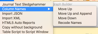

stan_koprowski
Re: How Do I Use Only Part of a Row of Data as Column Header?
Another option is to use the Column Names Utility Addin.
Select the columns you want to move up and then click move up.
Best,
Stan
