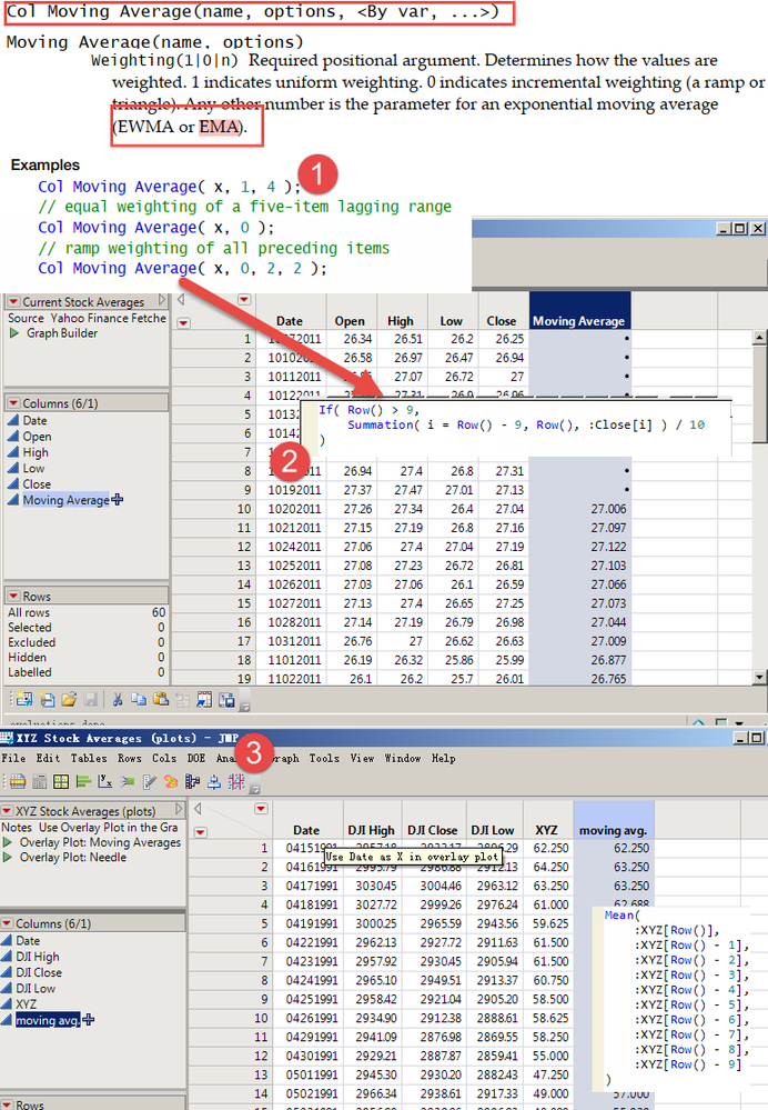

Now I want to use JMP for stock data statistics, but it is still a novice, find a few stock JMP sample file, did not see the calculation of technical indicators example.
For example, in the calculation of "MACD", I still don't understand the calculation of EMA.
After searching the manual books, the formula (mark 1 in the Image) for EMA in the manual is at the first place, but the formula (mark 2) in the example file does not seem to be this one
Consult to everybody expert, thank!

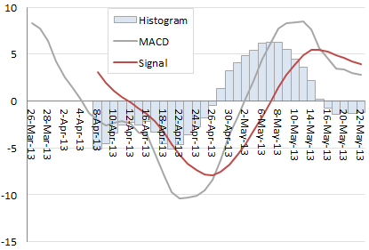

I found another website with an Excel sheet with MACD. The table I posted had the correct formulas except for MACD, it should have been EMA12-EMA26, my sign was the opposite.
The site with the Excel sheet is how-to-calculate-macd-in-excel.
Attached is a script that can be run on any table as long as the columns Date and Close  exist.  I simplified the EMA12 and EMA26 and Signal so that the SMA columns are not required. If High and Low are columns then the area plot is drawn, otherwise, not.

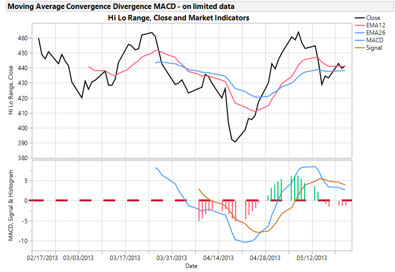

Below is the picture from the website regarding Excel followed by the Graphbuilder picture.
To test, open the JMP sample data table Current Stock Averages.jmp then run the attached script CalculateMACD.jsl. Note the graph will be dirfferent than the previously posted, since previously, I had the MACD sign reversed.

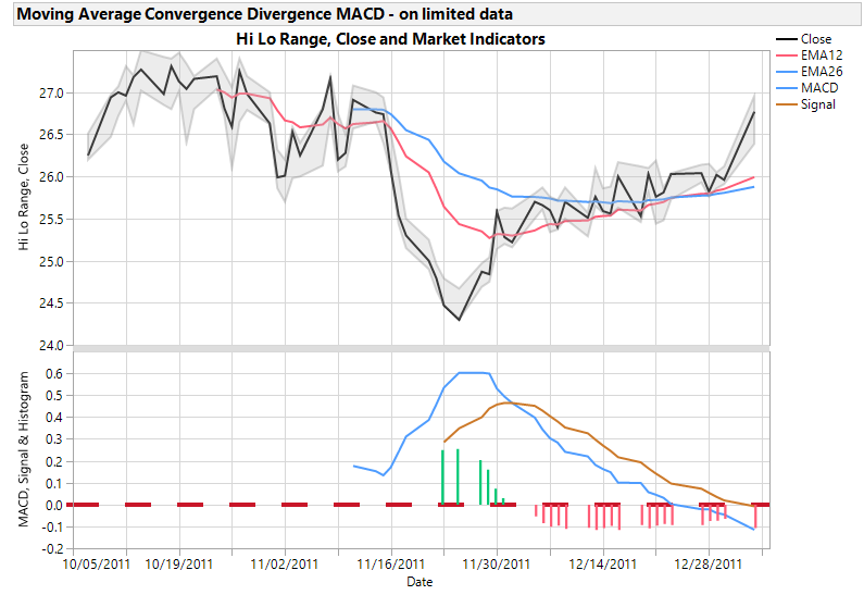

I believe there was a previous discussion (or wish list) for Hi-Lo-Close bars for GraphBuilder.  I did not look it up, but copped out with an area range for Hi-Lo and used a line for Close.
The script to create this plot is attached to the data table. Note to get the histogram of the difference of MACD and its signal to be red when negative and green when positive, two columns were used. They are named Bull (green) and Bear (red) and use the same difference formula but is conditioned on whether MACD > Signal.

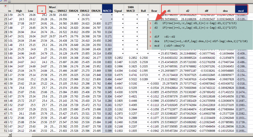

t seems to be a little different. On the right hand side are the formulas and results of my calculation.
Nevertheless I may use the result of the index oneself of stock software and computation check, the problem was solved,Thank gzmorgan0!

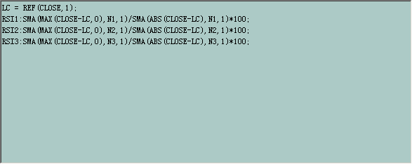

I'm going to try to compute the implementation of the "SMA" function in the RSI formula.Thanks!

The parenthesis indicated by the arrow can be omitted so that the two formulas are basically the same.If you have a lot of data, the error is negligible.
