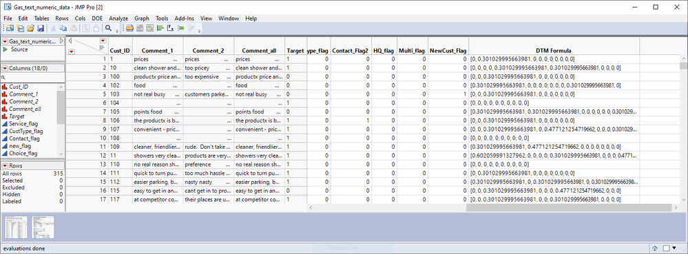

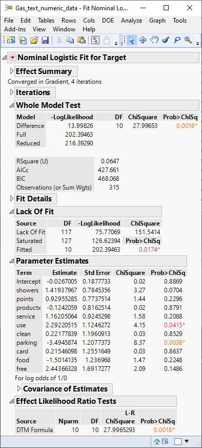

Re: How to update efficiently a table that contains a prediction model based on DTM (Document Term Matrix)?
Yes, it can be used as a set of predictors. Did you try?
Table with saved formula:
Logistic regression with array as only model term, but expands to all terms in the DTM:
