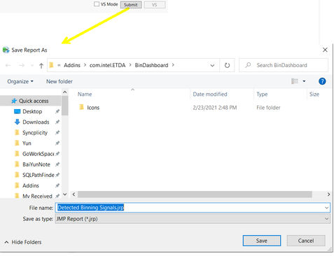

I am trying to get help from community members to see that if a "Save File Windows Explore" can be triggered as below screenshot after a button-clicking event?
Is there anyone who has an idea? Thanks in advance.

Seems like you cannot yet directly save .jrp through JSL Save charts as ".jrp" file in JSL but JMP16 will bring this possibility.
You could save it as text file with Save Text File and using empty path (it should open Save As menu). Save Text File returns the path to the saved file -> change saved file type from .txt (or something else) to .jrp with Rename File.

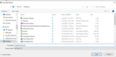

I saved my file as text file with Save Text File and using an empty path (it should open Save As menu). Save Text File returns the path to the saved file -> change saved file type from .txt (or something else) to .csv with Rename File. But eventually, the file haven't been saved successfully. Do you know why?

But if using the way you showed me, the user is not able to save files to any name or anywhere as they want?

It was showing that the idea should work.
Add additional prints, waits, stops and check what this does. It seemed to be working fine for me.
