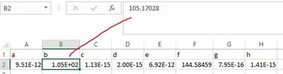

I'm trying to import an .xlsx into JMP using Excel Import Wizard. It seems that JMP keeps truncating the excel scientific notation data to 3 significant digits.
First image shows the view over in Excel - the data is in scientific notation with 2 decimal points shown but with 8 significant digits.

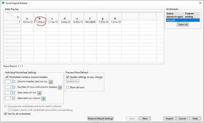

Second image is the Excel import wizard view.

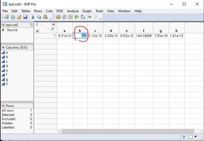

Third image is the resultant data table view in JMP - data is truncated to 3 significant digits.
Please share tips on how to stop JMP from doing this. I would like to maintain similar significant digits as the excel spreadsheet.

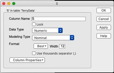

Just a quick question, if you right click on the column where the data looks truncated and get Column Info. what is the width set to? If you change that value, you will change the # of sig digits. Not sure if this will solve your problem.  There are also some options selecting the Best option drop down.
qlim
Level II
Re: How to stop JMP from truncating excel scientific notation format
That doesn't do anything, since the importing wizard have already truncated it to 3 significant digits.
See image attached.
