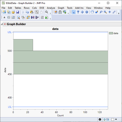

How to show USL/LSL lines enabled via the property "Show as Graph Reference Lines" in box-plots/distribution via Graph Builder?
I am coming from here
https://community.jmp.com/t5/Discussions/How-to-programmatically-enable-quot-Show-as-Graph-Reference...
where I got help to enable "Show as Graph Reference Lines" programmatically. However the USL and LSL blue lines are shown at the extremities of the y-axis when I generate box-plots or distribution via the Graph Builder. This is not satisfactory. I have attached the data table with plotting script inside to show the effect.
(This is not the case for the example shown in the post I linked above for some reason! why?)
I would like to auto-scale the y-axis each time I plot a column in my actual data which all have different limits and scales so that the horizonal blue lines for LSL/USL are always visible on the y-axis. How to achieve this in JSL?

Like Jarmo, the autoscaling works ok for your script in my iteration of JMP.
It is possible to do this in JSL though (and I'm sure that better JSL scripters than me would produce cleaner code than me!) by using the axis settings:
dt= current data table();
Lim = dt:data << Get Property ("Spec Limits");  //gets array of Spec limits for named column
// Use Spec limit values to set Axis limits (currently as Spec limit +/-10)
dt:data << Set Property(
	"Axis",
	{Min( (Lim ["LSL"]-10) ), Max( (Lim ["USL"]+10) ), Inc( 10 ), Minor Ticks( 1 )}
This works for the data column in the table you shared, and shouldn't take to much change to loop through a number of columns in a table

@Stuart_Little  Thanks but this does not appear to be generic solution (due to the +/- 10).
When it's too good to be true, it's neither
Re: How to show USL/LSL lines enabled via the property "Show as Graph Reference Lines" in box-plots/distribution via Graph Builder?
Hi @Neo
The +/-10 was just to illustrate the point - it's simple to set the Axis limits to +/-5% instead by changing to something like the below:
// Change column property: data
	"Axis",
	{Min( (Lim ["LSL"]*.95) ), Max( (Lim ["USL"]*1.05) ), Inc( 10 ), Minor Ticks( 1 )}
Of course, taking this approach will still run into issues if your data breaches both your spec limit, and whatever level you choose for the axis limit.
As you're on 16.2.0, the easiest first point of call would be to ask your site JMP representative to upgrade to JMP 17  to see if that helps resolve the issue - As I said, I can't duplicate your exact problem when I run your script in 17.1, so that will hopefully be the simplest way to resolve this!
