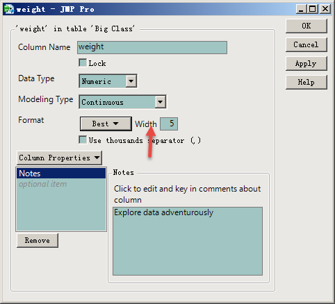

How to set the number of characters in a specified column by JSL?
I tried this JSL,
column("")<<Set Display Width(50);
but it does change the width of the column.It does not change the number of characters displayed.
Thanks!

Get the table script from red triangle next to data table name and check how format is set and by using that information you should be able to do the change.
Names Default To Here(1);
dt:weight << Format("Fixed Dec", 2, 0);
