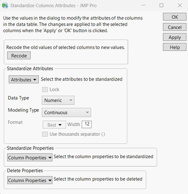

Hello @Neo,
When selecting multiple columns, you can right-click on them and select "Standardize Attributes" (Standardize Attributes and Properties Across Columns (jmp.com)) :
Looking at the script log, you can then extract the code for this attributes standardization. Example here is :
// Standardize column attributes
Local( {old dt = Current Data Table()},
	Current Data Table( Data Table( "Test" ) );
	For Each( {col, index}, {:Column 1, :Column 2, :Column 3},
		col << Data Type( Numeric, Format( "Fixed Dec", 12, 2 ) ) << Set Modeling Type( "Continuous" )
	Current Data Table( old dt );
