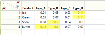

How do I select & colored the Top 5 highest value cell from many columns using JSL?
Example:
From all cells in column Type_A to Type_D (the similarity of these column name is it contains "_")
I want to select & colored the Top 5 highest value cell with yellow.
It seems "Select Where" function only applicable to comparing 2 columns.
Expected result should be something like this;
0.14, 0.12,0.11,0.1, 0.9 are the Top 5 highest value cells.
Thank you.

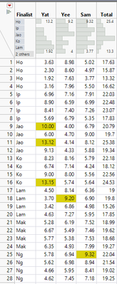

There is an option using matrices (interactive solution suggested by Jim is much easier to understand and was the first idea that come to my mind also)
Names Default To Here(1);
// This table shows how this will behave with ties
// dt = Open("$SAMPLE_DATA/2D Gaussian Process Example.jmp");
// cols_of_interest = {"X1", "X2"};
dt = Open("$SAMPLE_DATA/Pogo Jumps.jmp");
cols_of_interest = {"Yat", "Yee", "Sam"};
m = dt[0, cols_of_interest];
v = Shape(m, N Items(m));
r = Ranking(v); // let Ranking decide our top5
idx = Loc(r > N Items(m) - 5);
vals = J(1, N Items(m), .);
vals[idx] = 1;
vals = Shape(vals, N Items(m) / N Items(cols_of_interest));
For(i = 1, i <= N Cols(vals), i++,
	rows_to_color = Loc(vals[0, i]);
	Column(dt, cols_of_interest[i]) << Color Cells("Yellow", rows_to_color)
Write();
Pogo Jumps.jmp - Yat, Yee, Sam
2D Gaussian Process Example.jmp - X1, X2 (note the behavior with ties)
-Jarmo
