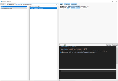

You can quite often find the messages with the exact name of the menu item from Script Index
In this case I think the example doesn't work due to incorrect syntax, so remove invisible from it
Names Default To Here(1);
dt = Open("$SAMPLE_DATA/Students1.jmp");
dt2 = Open("$SAMPLE_DATA/Students2.jmp");
obj = dt << Compare Data Tables(compare With(Data Table("Students2")));
summaryDT = (obj << save difference summary());
