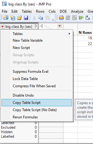

  1. Go to the Table Panel in the summary table and click on the red triangle and select Copy Table Scriptsave1.PNG

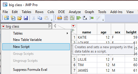

  2. Then go to the original data table's Table Panel and select New Scriptsave2.PNG
  3. Now, in the dialog box that pops up, paste in the data table script, and give the script a catchy name and you are complete       save3.PNG
