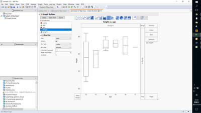

Hi, Is there any way I can save the linked subset? I have a main data table, from where I created a subset table. With that subset table, I created a plot. If I want to save the whole project and open it again, then the linked part doesn't work. If I select data in subset table, it doesn't select data in the main table. Does anybody know how to do that?

U can create a project and put your main data table inside. Then subset and draw your graphs.
After that, save the project by your path. JMP will create a project type file. Click the file can open all in your project.
