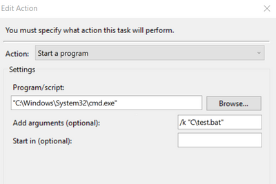

I was able to run the above simple script automatically when the button "Run whether the user is logged on or not"  was selected.
The solution to run it - I added /k in Task Scheduler - see below.
But when I try to run a complicated script (pulling data from the server and saving output on the server) It still does not work - It stuck on running status . any advise please?

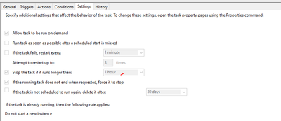

The task scheduler .jmp will still show running unlimited time if I click it to manual run through Task Scheduler.
So I forced it to stop after 1 hour through the task scheduler setting.
Can check back the results after the "1 hour" done. It will show as "ready".
My report ready to view the next morning even though the PC is log-off during the script running.
