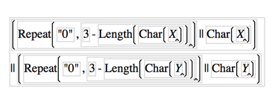

Assuming X and Y never exceed three digits, this should work in a column formula:
Repeat( "0", 3 - Length( Char( :X ) ) ) || Char( :X ) ||
Repeat( "0", 3 - Length( Char( :Y ) ) ) || Char( :Y )

Re: How to represent numeric value "1" as "001"?
Thanks. Exactly what I want.

You can use the Repeat() function to pad out the character representation for these coordinates.
It would look like this:
(Repeat( "0", 3 - Length( Char( :X ) ) ) || Char( :X )) || (
Repeat( "0", 3 - Length( Char( :Y ) ) ) || Char( :Y ))
I've attached your data table with a new column showing this.
-Jeff
