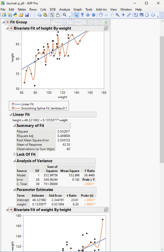

How do I delete Smoothing spline controls? I have a report with bunch of splines and this list of controls takes the whole page effectively collapsing the chart. I saw a similar question, but I have another part in my script and the solution doesn't work.
How do I remove it?

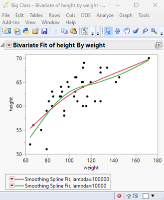

Here is a simplified version of your supplied code.  It simply opens the data table, runs the Bivariate code, and then removes the spline controls
Names Default To Here(1);
biv =Bivariate(
	Y( :height ),
	X( :weight ),
	Fit Spline( 100000, {Line Color( {212, 73, 88} )} ),
	Fit Spline( 10000, {Line Color( {61, 174, 70} )} )
(Report(biv) << XPath("//IfBox")) << Visibility("Collapse");

I need to keep the code the same way because I have more things to display
g=vlistbox(dt<<
Fit Group(
	Bivariate(
	Y(:height),
	X(:weight),
	Fit Line({Line Color({76, 114, 176})}),
	Fit Spline(0.1, {Line Color({221, 132, 82})})
	Bivariate(
	Y(:thickness),
	X(:date),
//This is the solution given to the question, but its not work for me, I guess because the vlistbox and fit grop
(Report(g) << XPath("//BorderBox"))[2] << Visibility("Collapse");
//this might collapse too much, so make sure it doesn't
(Report(g) << XPath("//IfBox")) << Visibility("Collapse");

thank you all for the help, combined with all the answers i use this code, and its work for me:
obs = vlb<< XPath("//IfBox/OutlineBox"); // might collapse too much, but you could limit it to the specific reports
obs << Visibility("Collapse");
obs = vlb << XPath("//BorderBox/ListBox"); // might collapse too much, but you could limit it to the specific reports
