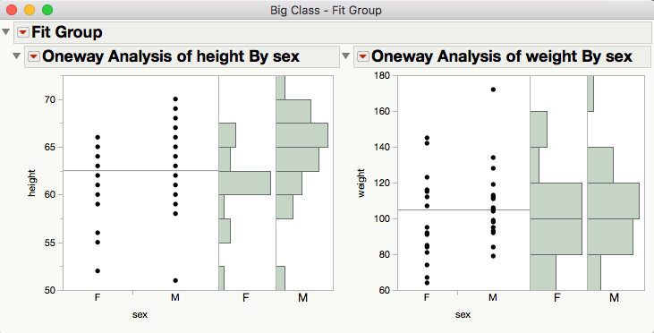

Perhaps you have a specific reason to want to use 'Distribution'. But you could also consider stacking your two tables and using 'Fit Y By X'. The code below shows the idea:

which gives:
