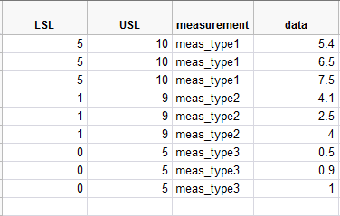

How to plot different spec limits for multiple variability charts
For variability analysis, I need to plot specs limits or ref lines (essentially both work for me) for every measurement type. In other words: Limits are different on every variability chart.
Spec limit source is in the same data table in a different column.
I don't want to set spec limits/ manually
How can this be scripted?
appreciate your help, I've tried lots of ideas but none have worked for me

Re: How to plot different spec limits for multiple variability charts
there is an Addin that will handle this
Write limits from a limits table to a data table
