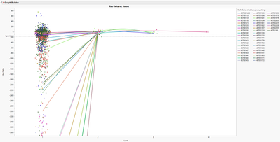

Hi there, I have a question on how to model some data I am looking at (JMP 11).
End goal: Display a Chart that shows Count of values of a Nominal Data Column (X) Vs. Continuous Data Column (Y).
Further in the weeds:
I have a Nominal Data Column: DieNumber.
And a Continuous Data Column: ResDelta.
I want to display the count of each DieNumber (ex: 1, 2, 3) displayed on the X axis instead of each DieNumber value, but in Graph Builder switching the summary statistic to N when ResDelta (Continuous) is plotted on the Y axis is summarizing Y and not summarizing the counts of each value of X.
The only workaround I've found is using the Overlay Plot function, associating ResDelta as \[Y\], associating DieNumber as \[By\], but this splits out each chart individually when I want the data all in one chart.
Really struggling with this so any help would be appreciated, thanks!

Jakedahsnake
Level II
Re: How to plot Count of values of Nominal data vs. Continuous data
Thanks for the help everyone, if this clarifies things I would like to present a similar problem that might be easier to understand.
Example Problem:
Tim, Alex, & Sara run around a track. After each lap, a measurement is taken of Calories burned.
Tim ran around the track 2 times with Calories Burned: 75, 155 resepectively.
Alex ran around 4 times with calorie measurements of: 60, 130, 195, & 240 cal.
Sara ran around 5 times with measurements of: 65, 125, 180, 235, & 280 cal.
How do I plot (# of times ran around) vs. (Calories Burned)?
To relate this back to my problem:
(Nominal) Names = ChipDieNum,
(Nominal) # of times ran around = Count of ChipDieNum,
(Continuous) Calories Burned = Delta Res.
For the record I have 8,000+ data entries that I would like to model.
Aah, thank you ask this example clarifies your use case!  If I understand correctly, you want all of the individual track times plotted as separate points, not just a single point representing both of Tim's runs.  I would approach this by making a column counting the number of times each person ran around the track so far, and then just plotting that against Calories Burned.
The formula for the times around track column could look like this (note how it just sums the number instead of having a column reference in the first argument):
Script to recreate chart:
This is super close, I don't think JMP 11 has Col Cumulative Sum() as an argument. But that is the type of graph and modeling I am trying to see!
txnelson
If you sort your data by "Name" (Using @ih example), the following formula will give you the Column Cumulative Sum in JMP 11
If(Lag(:Name) != :Name | Row() == 1, x = 0);
x++;
x
Jim
Jakedahsnake
Level II
Thanks for your help! Here's what it ended up looking like. I'll clean it up a bit more, but that's it!
