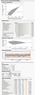

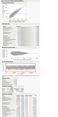

During performing Fit model, I found that picking different parameters will generate different outcomes. After having the model, I try to take a look on data points with high Studentized Residual and validate whether they are valid or not . I need to repeat the task of picking parameters a lot of time to get the proper model. Lets take a look on an example below
Model 1:
Model 2:
As you can see that, Model 2 has a lot of data points with high Studentized Residual compared to Model 1's. When I validated these data points with high Studentized Residual, these data points were data points categorized as Bad. It seems that Model 2 is more robust
My question is although 2 models have high RSquare scores, why Model 2 could screen out more bad data points. It could be because of parameters that I picked for creating the model
