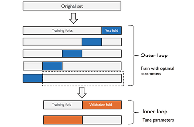

  • You may have to use nested cross-validation (if already using cross-validation) or cross-validation on your training set (and using the validation set to compare the models' performances) if you want to fit several models and tune them. The added data splitting is here to make sure that you're not overfitting with the hyperparameters optimization, and that a part of your data can still be used to do algorithms comparison and selection in a fair and "as unbiased as possible" way.
  • A possible problem with this Model Screening platform is that the crossvalidation option is by default random. Depending on your dataset and the distributions of your features/inputs, this may not be a sensible choice and would not provide a fair assessment and representativity of your dataset. A workaround could be to create a stratified formula (K-folds) validation column and use it in the validation panel of the model screening : Launch the Make Validation Column Platform (jmp.com)
  • If you really want to try and tune several models with this platform or any AutoML platform, think about the number of models that need to be fitted and the time and computations needed : you'll need to fit each selected type of model KxK' times (nested cross-validation with K = number of outer folds for model validation, K' = number of inner folds for hyperparameters tuning). Depending on your dataset, its dimensionality and complexity, this "brute-force" approach may not be reasonable and achievable.

Victor_G
Re: How to modify hyperparameters in Model Screening platform
Hi @Wang123,
I find steps 1) and 2) appropriate.
Steps 3) and 4) could be combined, to find optimal hyperparameters of severals models, evaluate, compare them and select a final model. You also need a validation strategy for this step, as optimizing hyperparameters without any validation would lead to overfitting. Depending on the results of this hyperparameters optimization on the (K-folds?) validation set(s), you select an algorithm which seems to be the most appropriate.
Depending on your validation strategy, you either keep the algorithm trained as it is (if you have used a validation set to compare and select a model), or you can do models stacking if you have used K-folds crossvalidation (to get the average prediction from the individual models).
In step 5, you assess the performance of your final model on new and unseen data. There should be only 1 algorithm/model at this stage. Validation is used to compare and select a model, not the test phase.
Concerning your questions:
"In step 2, can I just report the results of model comparisons (results of K-fold cross-validation) with default hyperparameters in the article?" : It depends what you want to show/demonstrate. If you want to explain why you have chosen some specific models, you could use the results of step 2. It makes more sense to compare results from step 2 and 3 on the selected algorithms if you want to highlight the importance and benefit of hyperparameters tuning (which is not always important for some robust models like Random Forests).
"In step 4, I didn't set up any cross-validation method, is this correct? Or is there another way?" I wouldn't recommend refitting on the entire training set, unless you use robust algorithms and have metrics to ensure you're not overfitting. Random Forests are typically good examples of robust algorithms and have internal validation (for continuous response) through Out-Of-Bag samples : https://www.jmp.com/support/help/en/17.2/#page/jmp/overview-of-the-bootstrap-forest-platform.shtml#
Comparing metrics of the In-Bag and Out-Of-Bag samples can help you assess if your Random Forest may have overfitting.
If you're using a different algorithm and/or not sure about its robustness, just keep your optimized (and validated !) model from previous step (or the stacked models if you were using K-folds crossvalidation).
Hope this last answer will help you,
PS: Don't forget to "Accept as Solution" the answer(s) if they were helpful to you, it's a good way for other JMP Users to quickly get to the solution without reading everything.
Victor GUILLER
