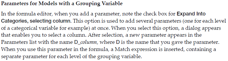

See Help > Books > Predictive and Specialized Modeling. I assume that you read the chapter about using the Nonlinear platform and you are specifying a custom model with a column formula. Did you notice the section about using the levels of a categorical predictor (such as crop) as a grouping variable in the model?
