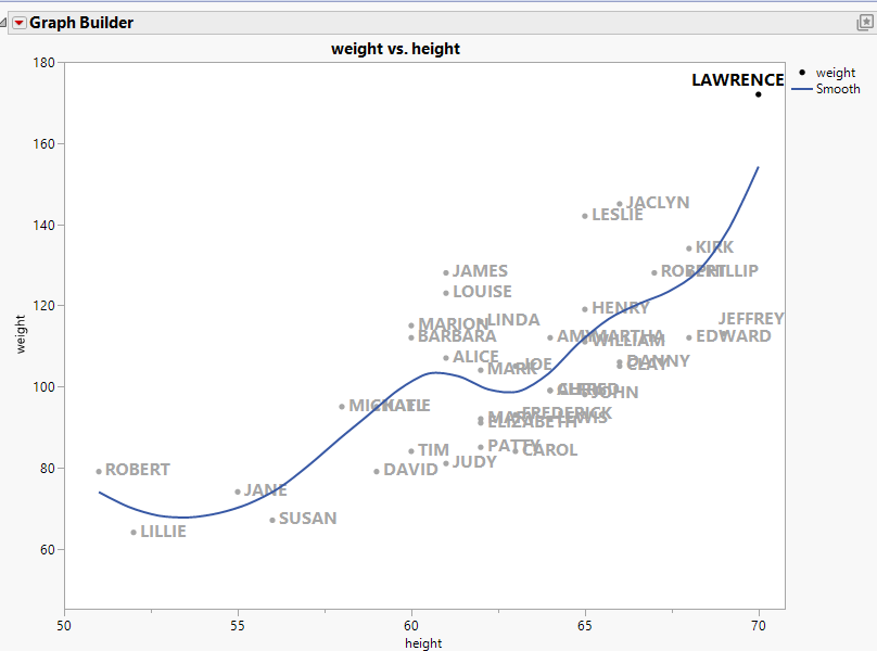

Re: How to interactlvely add a label value, from specific column, above a data point in graph builder on JMP18
@Thierry_S . Thanks. This works. How to I make the font of the lables bold?
Thierry_S
There is no simple means to affect the font style of the labels. The only trick I know to make the labels bigger (not bold) is to increase the overall font size using the SHIFT + CTRL + PLUS keys on your keyboard.
There is a rather complex alternative using scripting, but you would need to retrieve the data coordinates on the graph via script, assign the text label recursively, and format the text all within the script.
Best,
TS
Thierry R. Sornasse
OK. I will resign to the faint font :). Thanks for the help.

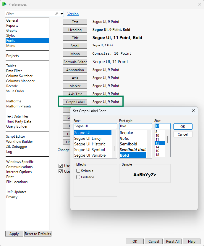

Hi @GeneratingBunny ,
If you are fine with changing a preference for the labels, which would affect all graphs, you could increase the Graph Label font size and make it bold on this preference page:

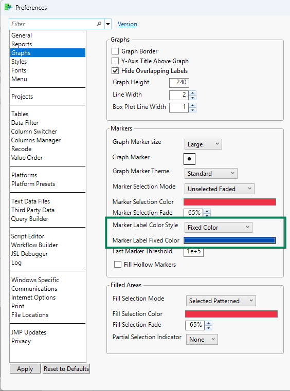

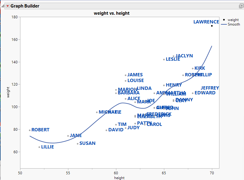

If you are unhappy with the label being drawn in the same faint color as the marker (selected, black, unselected gray), you could override the marker label color preference too.
I hope this helps,
