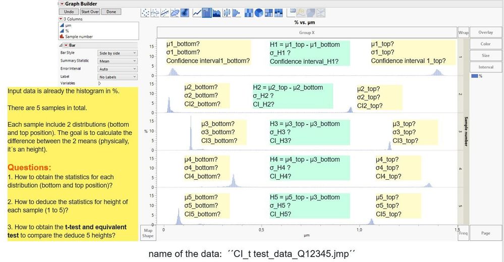

How to get the confidence interval (CI ) and to make t-test with multi distributions in one histogram (as direct input data)?
Input data is already the histogram in %.  There are 5 samples in total. Each sample include 2 distributions (bottom and top position). The goal is to calculate the difference between the 2 means (physically, it´s an height). Raw data (´´CI_t test_data_Q12345.jmp´´) is attached.
Questions:
  1. How to obtain the statistics for each distribution (bottom and top position)?
  2. How to deduce the statistics for height of each sample (1 to 5)?
  3. How to obtain the t-test and equivalent test to compare the deduced 5 heights?
Many  thanks for your help!

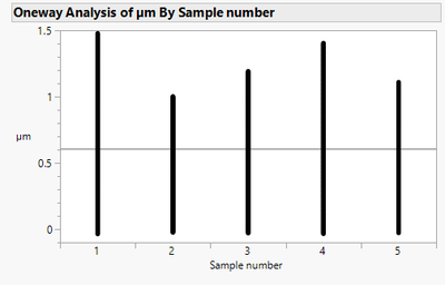

  To me, it sounds like you need to do an ANOVA test of the data. Use the Fit Y by X platform, and use um as Y and sample number as X. This will show a picture like this:

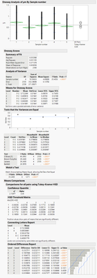

Then, go to the red hot button next to Oneway and select Means/Anova. You should get this:
Notice that the "Prob > F" is <.0001, so this means that the Sample number has a high probability of explaining some of the variation in the Y (um). Before continuing, you will want to do a test of unequal variance to see if the variance from sample number to sample number is the same or different. Again, red hot button, then select unequal variance. You should get this:
All of the unequal variance tests have Prob > F to be <.0001, meaning that the variances are NOT equal. But, the Welch test also has a Prob > F at <.0001, so even though the variances are not equal, you can continue with the ANOVA comparison. Next, you CAN do a Student's-t test, but since you have more than two levels (the number of levels for Sample number is 5), you'll actually want to do a TukeyHSD test. If you do a Student's-t on this data set, you might be mistakenly saying there's no difference when there actually is a difference, Type II Error (I think).  Again, go red hot button, then Compare Means > All Pairs, Tukey HSD. You should get this:

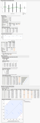

You can see there is some overlap between levels 2 and 5, but otherwise, there are distinct differences in the means. Within the Oneway platform, you can do an Equivalence test. Again, red hot button and then select Equivalence test. For the variance assumption, you'll need to select Unequal Variances since the tests all came back with very low p-values. You'll then need to enter a value that will be practically equivalent or not. You'll then get this (I put in 0.2):
What this tells you (given my value for equivalence) is that 3 out of the 10 pair-wise comparisons are different while the other 7 are practically equivalent.

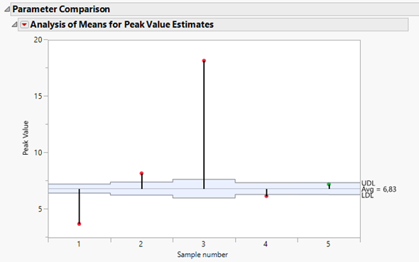

I still face difficulties. Because at the end, I need to compare the height and the statistics of the height in µm. The height of each sample can be defined as the difference between the z position at the bottom_peak (in um) to the z position at the top_peak (in um). The height should also has a confidence interval, which is deduced from its corresponding top and bottom distributions, correct? I don´t know how to do this.
I think the difficulty in the problem is that the input data is a histogram which includes the z position ( in um) and the frequency in %. The frequency indicates how the z positions are distributed. The corresponding physical module is to analysis and compare the height of the binary (step) samples. That´s why it´s calculated from the z position difference between top to bottom.
Trying to put the % column into the Analyze -->Distribution --> Freq, it seem to be good, but still I can´t get the height statistics and compare the sample heights by JMP.
One of the output I need is the parameter comparison plot as below (example copied from your solution), but to compare the height in µm (instead of the Peak Value, I know you just give it as an example). Thanks for your help!
