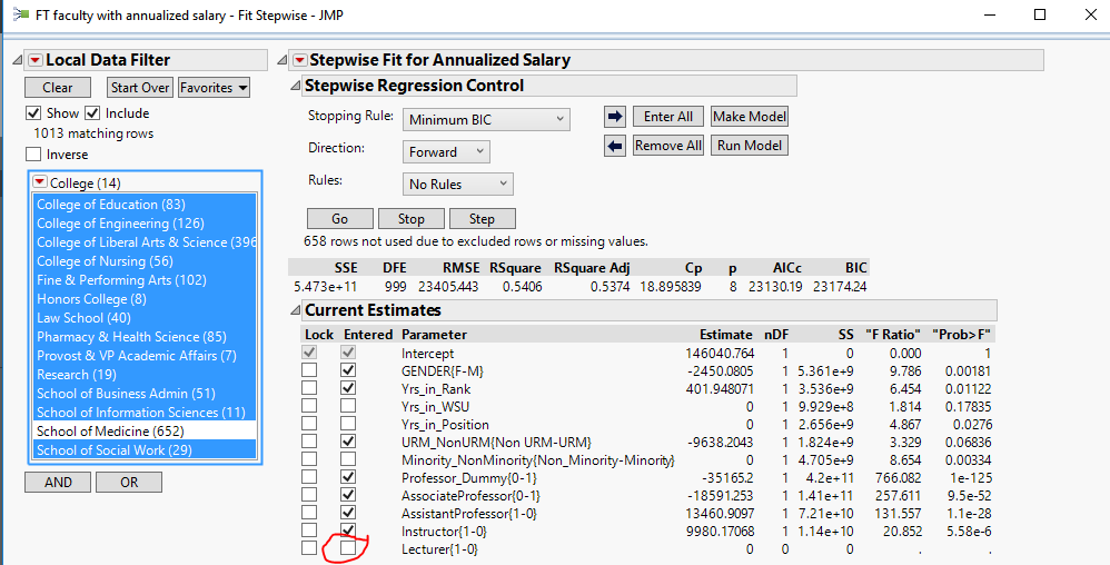

I'm doing a stepwise regression to study the effect of some parameters on salaries. So:
Dependent variable is: salary
Independent variable are: gender, yrs_in_rank, URM_NonURM, Professor, AssociateProfessor, Assistant Professor, Instructor, and Lecturer (Professor, associate Professor, Assistant Professor, Instructor and Lecture are the five ranks of the study pool, they are recoded as dummy variable based one source column)
When I try to enter the above parameters, most parameters are entered except Lecturer. In fact, I can only enter four out of five ranks. I dont know why. I suspect it might be due to collinearity, but how could JMP know they are collinear variable? Is there a way I could enter all of five ranks into the analysis?
Thank you!

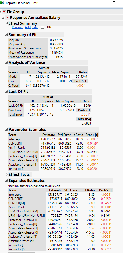

This is a common issue that comes up.  JMP always leaves out one category from the model - it has to, or the model will be over-identified (in lay terms, if we know an inidividual is not in the first 4 classes, they must be in the 5th, so that information would be superfluoous - in more mathematical terms, the matrix would be singular and not invertible).  If you want to see the full set of categories, click on the red arrow at the regression output and ask for the Expanded Estimates.  The missing category will have a coefficient that, when added to all the other category coefficients, sums to zero.

Also I tried to expand the estimates, it shows expanded results for selected parameter, and the 5th variables’ estimate still missing.SASJMP_Stepwise2.PNG
