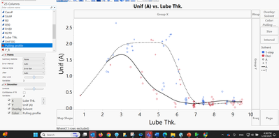

I am new to this community and thank you in advance to all the members for your help.
I tried to create a plot via Graph Builder with more than 1 variable, currently display as A & T smoothers. I would like to get 4 smoothers displayed, as A + 1-step; A + Osci; T +1-step; T + Osci instead. Basically adding pulling profile (A, T) into the overlay, together with Solvent.
Is it possible to do so?

You could concatenate the two columns (the one currently in overlay and the one currently in color) into a single one and then use that for the overlay.  That should give you 4 different smoother functions.

Which JMP version are you using and can you share small example data table so we know how your data looks like (sometimes you have to split/stack data first).

Works beautifully. Thank you very much for sharing.
