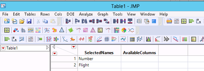

An extension to what I was previously working on:
Using the same data as the previous question, based on the selected words that I want from the available columns in data table "Air Traffic", I am expecting an output as shown below if the available columns in the data contains the words in the "SelectedNames" column at their respective rows:
However I am getting this error message in Log & no insertion of any correct column names in the second column:
These are my codes, can you help me to check what's wrong with them?

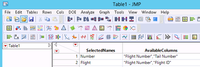

ian_jmp
Level X
Re: How to get columns names that contains certain words given by user?
You need to distinguish between a list and the type of items that it holds (which, in general, don't have to be homogenous). The error is due to the fact that you are trying to put list xxx (which happens to contain items that are all character), into a cell in a character column.
The best way to do this will depend on what happens next in your code. I suspect that you might want to have 'AvaliableColumns' as an expression column, rather than a character column:

ValarieSimmons
Level III
Thanks again Ian.
Your solution works like a charm!
