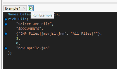

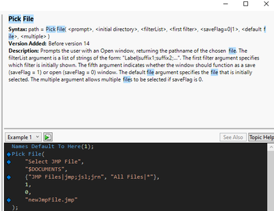

I don't think you can use TestStage for filtering using Pick File. Pick File in scripting index will tell you how to limit Pick File to only JMP files
Names Default To Here(1);
Pick File(
	"Select JMP File",
	"$DOCUMENTS",
	{"JMP Files|cap*jmp;jsl;jrn", "All Files|*"},
	1,
	0,
	"newJmpFile.jmp"
The  LineUp message comes because Set Hint is in wrong place (it should be inside Text Edit Box)
Edit: Set Hint and Set Tip have different uses, so don't get them confused
-Jarmo

See Pick File from Scripting Index for file selection
It could be that the suffix is basically only file extension, so you can only limit it to .jmp unless you build your own file selector.
https://www.jmp.com/support/help/en/17.0/#page/jmp/file-functions.shtml?os=win&source=application#ww...
You might be able to help the user a little bit by using default file argument.
Pick File(
	"Select JMP File",
	"$DOCUMENTS",
	1,
	0,
	"newJmpFile.jmp"

@jthi Thanks. I was wondering if the "All Files|*" could be used to filter further. If not I will proceed as is.
When it's too good to be true, it's neither
jthi
Re: How to get browse to folder and select file option inside a modal window?
It is very helpful to run examples directly from Scripting Indices run button
Multiple filters will give you these options:
I can edit that same example directly in Scripting Index
 and run it again to see what is different
and then you can reset it back to original if you want to
If you are testing anything more complicated I would suggest you copy-paste the example to new script window and edit it there, reduces the chances that it will get reset like might happen in Scripting Index
