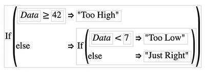

However, maybe a you are looking for a simple solution like:
If( :Data >= 42,"Too High",If( :Data < 7,"Too Low","Just Right"))
this is just a nested If statement if the data values is 42 or higher the formula returns, "Too High", then if data is less than 7 it returns "Too Low", and if its neither too high or too low, then the formula returns "Just Right"
You can paste the formula into the formula editor, and then substitute in the correct column name, values and messages.  (Right click on the column name, click on formula , and past the above JSL into the dialog)

Re: How to get a pass_fail column
I like simple, like me!
So I simplified it (no nesting required):
If( :Data >= 42, "Too High", :Data < 7, "Too Low", "Just Right")
