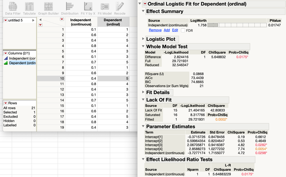

How can I calculate in JMP the odds ratio in an ordinal logistic regression with one independent, continuous variable [0-1], and one ordinal dependent variable [1,2,3,4,5]?
See the example in the screenshot, where it is unclear to me where I can find the odds ratio.
1 REPLY 1
Re: How to get Odds Ratio in Ordinal Logistic Regression?
Odds ratios are available only for a two-level nominal response.
You can save the prediction formula (fitted model) and compute the ratios as described here.
