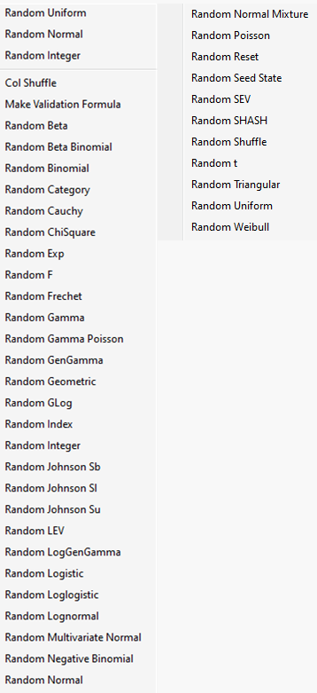

Here is a list of the Random Number functions that can be used to generate data of specific distributions.
The Random Reset() function can be used to set the initial seed to whatever value one wants.

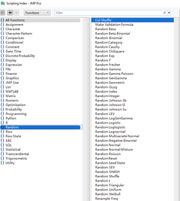

You may want to check out the random function category in the JMP Scripting Index:
