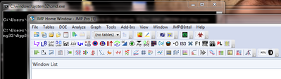

When use .bat to run one jsl file, I can close all the data tables using script in JSL file, while at the end the JMP home window still there, can't exit automatically.
when use older JMP version like JMP9, no such issue.
the contents of .bat and .jsl are as below:
the .bat file
the .jsl file, just very simple script to do datatable update.
After double click the .bat file, the jsl run normally, only the JMP home window can't exit automatically. becuase the JMP still open, so the windowns cmd window also can't close automatically.  Not sure if anybody suffer the same issue. Does anyone know how can close the JMP home windowns automatically?

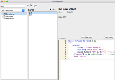

Try Exit(); or Quit(); at the end of your JSL script.

PS: The Scripting Index is your friend.
