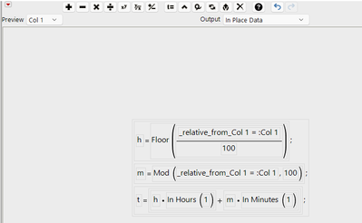

jthi
Re: How to fix a duration with missing colon :

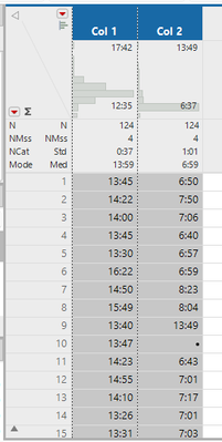

And the last method can be quite easily done from JMP interactively also.
1. Select all columns
2. Right click on column header
3. Create Formula quick column
4. Replace the formula using the relative styling
h = Floor(_relative_from_Col 1 / 100);
m = Mod(_relative_from_Col 1, 100);
t = h * In Hours(1) + m * In Minutes(1);

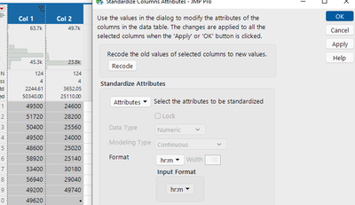

5. Change output to In Place Data
6. Click "Replace x"
7. Change format to duration hr:m using Standardize Attributes as currently you just have seconds visible with Best formatting
8. After clicking OK or Apply
And JMP is nice enough to write script for you

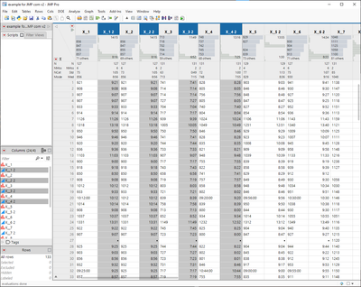

Except that sometimes, I just realized, the time is entered as hh:mm:ss
Is there a way to work around this as well? See example v2.
Cheers, C

jthi
If that is from real data (character columns with different formats)? Original example had numeric data if I remember correctly. Are the seconds always 00 as they are in the example?

Stats_Like_Jazz
Level III
Yes, unfortunately, this is from the real data.
I had selected two columns that did not have this issue, as I thought I could just use recode.
But I thought wrong, or at least I realized that using recode on 84 columns is too much for what I can bear.
Yes, the seconds are always 00.

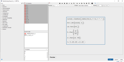

jthi
Formula for the quick formula method when the columns are character columns. This makes assumption that values which are already duration "formatted" will have zero padding for hour (such as 09:00:00)
numonly = Substitute(_relative_from_X__1, ":", ""); // remove ":"
hrm = Left(numonly, 4); // take 4 characters from left
val = Num(hrm); // convert to numeric for calculations
h = Floor(val / 100); // take only hundreds
m = Mod(val, 100); // remainder
t = h * 60*60 + m * 60; // convert to seconds
I create new columns here so I can easily compare them to the starting point. After creating formulas, do required type changes using standardize attributes (data type, modeling type, format)
