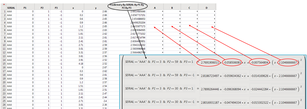

How to fit a polynomial degree 2 models with by-groups then capture the parameter estimates
I would like to create polynomial degree 2 by each (SERIAL, P1, P2, P3) and get the coefficient and constant then put in each column by using JSL.
The example data was attached in this post, but actually I will do with the data about 1 million rows.

Re: How to create polynomial degree 2 and get the coefficient and constant?
It would be possible to develop the script below to get what you need:
NamesDefaultToHere(1);
ClearLog();
dt = DataTable("Example data.jmp");
col = Column(dt, "Predicted y By SERIAL By P1 By P2 By P3");
// Get the formula generated by the platform
f = col << getFormula;
// Start to parse this formula expression
for(g = 1, g <= Narg(f) - 1, g = g + 2,
	f1 = Arg(f, g);
	f2 = Arg(f, g+1);
	Print(f1, f2, "\!n");
But I suspect it might be simpler to send the 'MakeCombinedDataTable' message to the appropriate table in the report window if that's possible. Look in 'Help > Scripting Guide'.
Hi MathStatChem,
Your solution it work.
Sibtid
Level II
Hi ian_jmp, My objective is get the coefficient and constant of "y = ax^2+bx+c" but in fit polynomial is "y = a(x-d)^2+bx+c". However I got the solution from user# MathStatChem by fit special.
