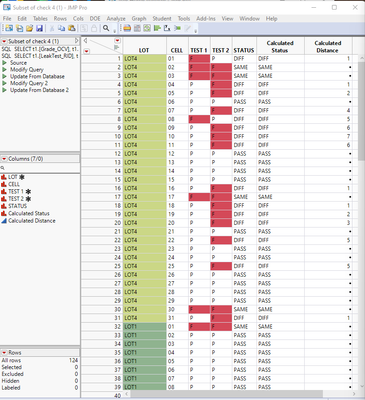

How to find the Max difference between two tests by counting number of cells between events.
I have attached a mini file.
If the cell of a lot passes TEST 1 and TEST 2 its status is PASS.
If a cell fails TEST 1 and TEST 2 its status is SAME.
If a cell fails a test but passes the other test its status is DIFF.
For each lot I am trying to determine the Max distance by cell count from a DIFF to its nearest SAME.
What would be the best way to go about this?
Thanks
Fiona

Here is a little script that calculates the new columns you want
Names Default To Here( 1 );
dt = Current Data Table();
dt << New Column( "Calculated Status",
	character,
	set each value(
		If(
			:Test 1 || :Test 2 == "PP", "PASS",
			:Test 1 || :Test 2 == "FF", "SAME",
			"DIFF"
If( Try( dt:cellNum << get name, "" ) == "",
	dt << New Column( "cellNum" )
dt:cellNum << set each value( Num( :CELL ) );
dt << New Column( "Calculated Distance",
	set each value(
		If( :Calculated Status == "DIFF",
			currLot = :LOT;
			cells = dt:cellNum[dt <<
			get rows where(
				:LOT == currLot & :Calculated Status == "SAME"
			dif = Min( Abs( Num( :CELL ) - cells ) );
			dif = .
dt << delete columns( "cellNum" );

Thanks Jim, this is perfect.
Can you explain what is happening at part of script below?
txnelson
Re: How to find the Max difference between two tests by counting number of cells between events.
First, it checks to see if there is a column called "CellNum" and if not, create it.
Second, set the values for the column.
