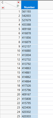

How to export column data to string or txt
I have the following data table, how can I export the column using JSL:
1. string = 561193, 542003, 527679...
2. export the data to .txt where the values show: 561193, 542003, 527679...
