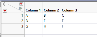

Hi All,
I'd like to export a txt file without double quotes,is there another way?
thank you.
<Datatable>
<Export Options>
<txt file>

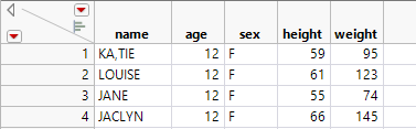

Re: How to export a txt file without double quotes?
The issue seems to be that there are commas in the column.  I added a comma to the first row's name in the Big Class data table
and then saved it as a txt file using your export settings, and what I got was
What I suggest is for you to separate each comma field into separate columns

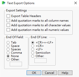

Set your export preferences to
and you will get
Jim
