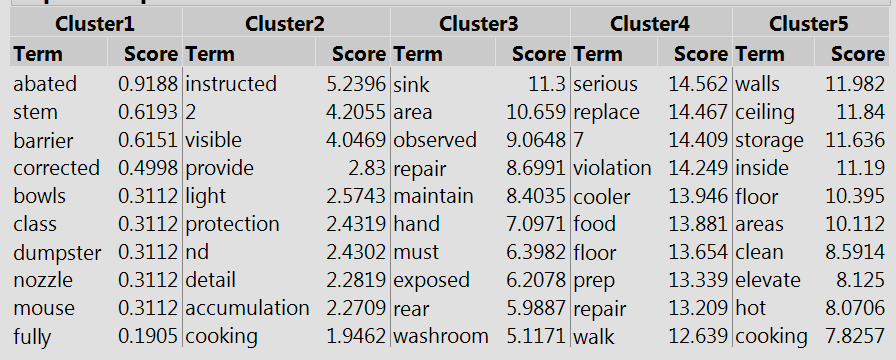

Text explorer can use the new column to form clustersclustersclusters

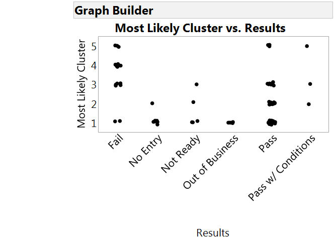

Plotting the cluster number for the comments against the actual inspection result looks promising; cluster 2 comments did not get failing grades and cluster 4 comments failed. Typically something like "OBSERVED GREASE BUILD UP ON VENTILATION HOOD FILTERS. MUST CLEAN VENTILATION HOOD FILTERS" (pass) vs "NO HAND WASHING NOR REMOVAL OF FOOD GLOVES" (fail).
clustered by comment textclustered by comment text

I don't think the 145K rows will be too slow for any of the parsing ideas. I think you will probably want indicator columns for each kind of violation, 0 or 1. If you have JMP 13, you can use text explorer on the comments; I'd suggest running all the comments, without the constant descriptions, together into a single character field.
