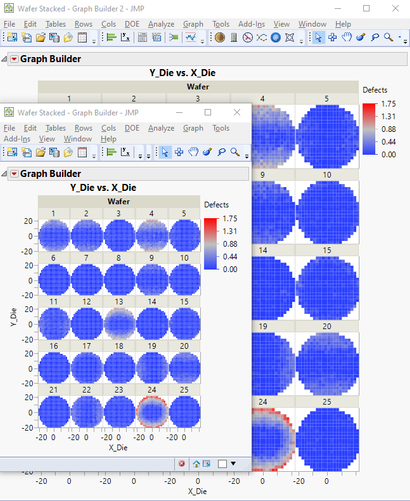

If I just run the expression, it will open in its own window, and there I can control FrameBox sizes, below is example of 50x50 on top of 100x100 FrameBoxes. Basically, that's what I need - only in a custom window without menus etc.
2023-08-31 13_00_06-Wafer Stacked - Graph Builder 2 - JMP.png2023-08-31 13_00_06-Wafer Stacked - Graph Builder 2 - JMP.png

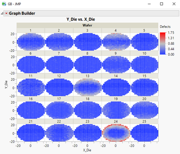

This is what I get if run it in the new window. No matter what sizes you specify - it ends up like this.
